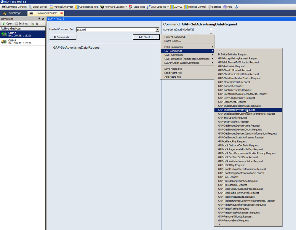

worldlu
how to use FSCI interface with qn908x dongle .
now I want use the qn908x in host to connecting with other BLE remote .
but the FSCI can't give me a detail function to do it ,
i use the test tool use BLE.xml to connect with qn908 dongle ,but can't get any information with it.
could anybody give any suggesting ?
1 返信
1,487件の閲覧回数
ovidiu_usturoi
An example of using the FSCI protocol is the ble_fsci_black_box. As a start point please consider Kinetis FSCI Host Application Programming Interface.pdf , chapter 9.8. BLE heart rate service use case. (sdk folder -> ..\docs\wireless\Thread/).
The python file contains an equivalent list of commands that can also be sent from TestTool ->CommandLine -> BLE xml commands set.
An example of accessing GAP commands from TestTool is below.
As a note, please consider that the FSCI  functionality is enabled by default on the following examples:
- ble_fsci_black_box
- otap_server - required for Over the air programming server implementation.
Ovidiu
