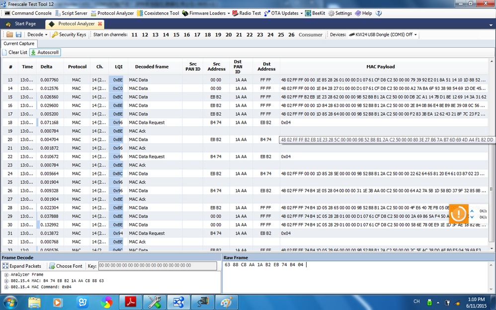

Thanks for your help,and I get the address of the nodes successfully.My solution is based on the WirelessUART template exported from Freescale BeeKit  Codebase,and I changed uicast to broadcast.This applay works as temperature measurement.
It can work well in the star networks.But once I made two nodes routers and one node coordinator in the network to expand the distance.Data from the coordinator go normally,the data from routers is sometimes unreadable code .what is more, it is like that there is something wrong with the router programe,it did not communication well.It Look like
I want to build a tree or mesh networks to expand the communication distance,but I can not find out the mistakes.I used to realise this function based on cc2430 and cc2530,and I did not have problems in networking.

Hello Zhao,
I do not think this is an issue with the over-the-air package. I would rather check the settings in serial terminal are correct. The default baudrate is 38400. Please try with another console such as Hyperterminal, Putty or TeraTerm and check if it happens there too.
You may also try unplugging and plugging the board to the PC and restart the terminal. I just tested a couple of WirelessUART projects (ZC and ZR) and it worked without problems.
