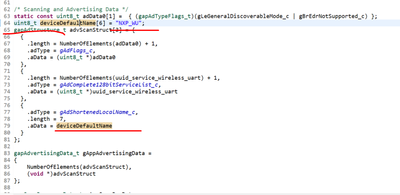

 trying to update the advertisement scanning at runtime it is working fine but when i try to update multiple time it is updating only few times not consistently updated . Can anyone please help me to solve this issue. Below is the code return in serial manager.c file. sending command as #ccdas_123 from iot tool box. This value i am storing in hardware parameters  and when i reset updated value is stores in advertisement structure.   But hardware structure is not updating sometimes.

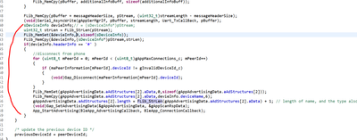

There are too many points you need to notice. So I wrote this program. Input '#' and after this char, it is your device name. For example, '#asdf', the adv name will become 'asdf'. Pay attention that the device name should smaller than 6 byte. This is due the limit of adv packet length.
I do not write adv name into memory. You can add it by yourself. The code is added at 'BleApp_ReceivedUartStream'.

When you send the new device name to mcu, you firstly write it into memory. And then make mcu disconnect from the phone using 'Gap_Disconnect'. Read the adv structure from the memory. Use 'Gap_SetAdvertisingData' to set the adv data. Use 'App_StartAdvertising' to start the adv again.

nxf56274
6,505 Views
thailivenkatesh
     Thank you very much for your support  now it is working fine and it is updating multiple times consistently.
