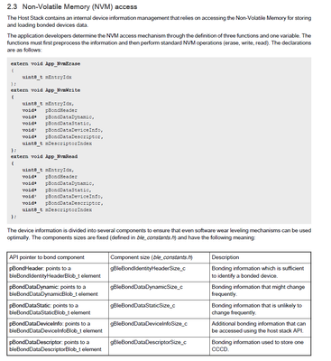

from IOT toolbox sending the new device name  as #ccdas_123 to FRDMKW36 to configure advertisement structure  for that I  want to  to read and write to eeeprom .Please help me how to read and write for storing the value.

There is a document named 'Bluetooth Low Energy Application Developer Guide.pdf' in 'sdk_FRDM-KW36\docs\wireless\Bluetooth'.
