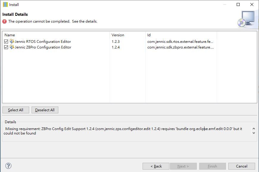

Hi all,
PC System:Windows 10 Home
beyondStudio version:JN-SW-4141 BeyondStudio for NXP v1308.exe
Zigbee SDK version:JN-SW-4168 ZigBee-HA-LL v2162.exe
Zigbee plugins installed failed?
4,831 Views
topalanlin
Re-try several times, still failed during installation.
However, I tried to clone the whole folder (ex: C:/NXP/) from another PC which has installed well before.
Finally, it works with the cloned folder on my PC.

Could you please confirm that you followed the steps mentioned on section 1.2.3(Installing the ZigBee Plug-ins) of the "BeyondStudio for NXP Installation and User Guide"?

How to fix the issue about "requires 'bundle org.eclipse.emf.edit 0.0.0' "?
