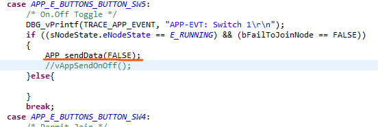

It works fine when I call the function from the button pressed case in the end device task:
as sniffer tool shows:

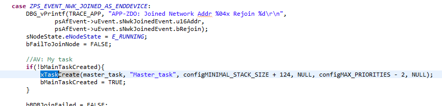

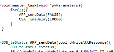

But if i send the same command from my custom task:
Creating the taks:
Sending from the Custom Task:
It doesn't work anymore and event triggers the watchdog.
What am I missing or which is the correct way to do this??

Why do you have a for loop? It is a big delay, did you try to enable that specific cluster?
I am assuming that your custom, you could create an event in the code that sends the data that you want.

The loop is just for testing right now.
What I'm try to do is get the data from a sensor, that I allready have working, send the data to specific cluster, that It's allready created too, put to sleep the end device for some specific time, say  one minute or five minutes, then wake up and repeat the clycle, so that's the way i'm starting and really want to know the best way to achieve it. The cluster part is allready working when the event is from a pressed button, but I need a timer event.

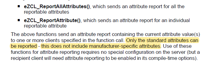

alejandrovelez
But i got this from ZigBee Cluster Library User Guide
How can I report manufacturer-specific attributes?
4,301 Views
mario_castaneda
Hi Alejandro,
You are right, only the standard attributes can be reported.
