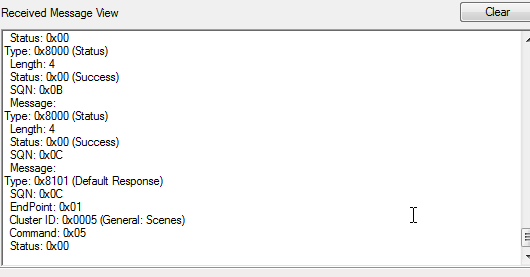

4,229 Views
dmsherazi
Hi , I have done that as well.
Here are the steps.
  • Add a group with id 0x0022 to endpoint 1,2,3 on a device with short id 0x00C9 -- result success
  • store a scene with group id 0x0022 and scene id 1 on endpoint 1,2and 3 on the device with short id 0x00C9 -- success
  • View scene  with group id 0x0022 and scene id 1 on endpoint 1,2and 3 on the device with short id 0x00C9 -- result shows that the scene exists and shows scene data as well of this type: 0x06 0x00 0x01 0x01
  • Change the state of lights on device
  • Send Scene Recall command with group id 0x0022 and scene id 1 on endpoint 1,2and 3 on the device with short id 0x00C9 -- result status of switches doesn't restore

mario_castaneda
Hi Dost,
What are you seeing in the received message view?
I followed your steps with one endpoint.
I change the state of lights on the device using the short and group address.When I send a recall command the status restored successfully.
But, How do you add more endpoints?
Did you have the sniffer log of this?
