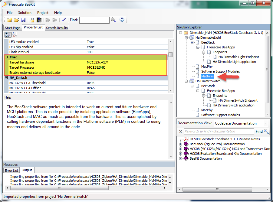

I'm working on a dimmable lamp, i've used a beekit preset and it works but i have a problem with the network rejoin.
What i want to do is make it remember the previous network, in way that  when  power out the lamp, once the power is back, it automatically  rejoin into the network.
I've seen that the beekit preset have a section in the code dedicated to storage data in the  NVM, but i  don't know how to use it.
So want to know is which data I need to storage in the NVM and how i do it , to make a network rejoin?.
The microcontroller i’m using is MC13237CHT.

Assuming you are using codebase 3.1.1, in the case of the Ha Dimmable Light demo application, with the default configuration, it should be enough to set the gNvStorageIncluded_d define to TRUE for an existing project, or check the option "Non-Volatile Memory" when creating the project in BeeKit.
After a device joins a network the stack will automatically save all the required network information into NVM. At startup the Ha Dimmable Light demo application will check if the device was previously on a network and, if that is the case, use the NVM information to silently rejoin the network. This way the device should automatically resume normal operation once the power is back on.
In the demo application the code for rejoining the network with NVM is located at the end of the BeeAppInit() function in BeeApp.c, where the ZDO_Start() function is called.

I've tried that but the first time i restart the device, it just seems like it has successfully connected to the network but it doesn't, the second time it just do nothing. I don't know i there is any way to know if the data saved is wrong or not, but if there is, i would like to know it.

I've tried that and it gets connected to the network, but immediately gets stuck in identify mode for a few minutes and then just stops.
I think It just doesn't get into run mode.

Is your switch a router or an end device? Please configure it as a router. Since the end device is sleepy, it would be useful to discard that the problem is related with the low power configurations.
I attached my BeeKit configurations. I tested with the MC13234C MCU so you need to change it to the MC13237C.
Earl.
