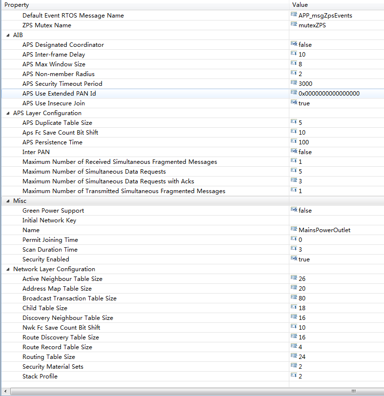

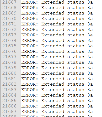

I use JN-AN-1223-ZigBee-IoT-Gateway-Control-Bridge-v1014 as the coordinator, connected 70 routing devices (MainsPowerOutlet in JN-AN-1189-ZigBee-HA-Demo), just started printing Normal, but after a while, the router will print ERROR: Extended status 8a, why is this? The document says that 0x8a is the device does not have storage space to support the requested operation, which parameters do I need to change?   please help me

By any chance do you have an external memory to support all of the data stored? I believe your problem will be most likely related for not having enough space in your device for all the nodes information.
Please consider that the memory of the device it's impacted for both the stack and your application size, once taking both into account, you will need to consider the different data to be stored of every node which.
The solution will be most likely to add an external memory so you can handle all the nodes information or consider adding more routers to the network.

yuboli
Thank you very much,
I use the JN569 chip, but the documentation says that there are no problems with 100-200 devices, and some people can connect 100 devices
But I can't, I can only connect 40-50 devices, stable operation.
Is the parameter not configured correctly?
