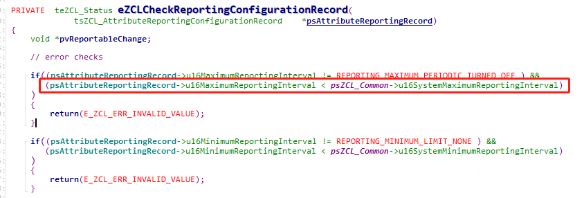

Hi nxp:
    The path is:
        C: \ NXP \ bstudio_nxp \ SDK \ \ Jacqueline Nottingham - SW - 4170 Components \ ZCIF \ Source
    and the file is:
         zcl_reportManager.c
    there is a function called:
        eZCLCheckReportingConfigurationRecord
    as below
This position is doing parameter check, when checking the maximum time interval, why is it illegal when it is less than but not greater than?

Hi Mario,
I looked at the document you said, but I didn't get the answer.
My question is that shouldn't we use the ">" here, rather than "<"
Because this location is compared to ZCL_Cmmon MAX interval,only if we pass in parameters beyond the ZCL_Cmmon MAX interval, it is E_ZCL_ERR_INVALID_VALLUE

Hi Zhang,
Thank you for your feedback, it should be like you suggest.
I am already reported.
