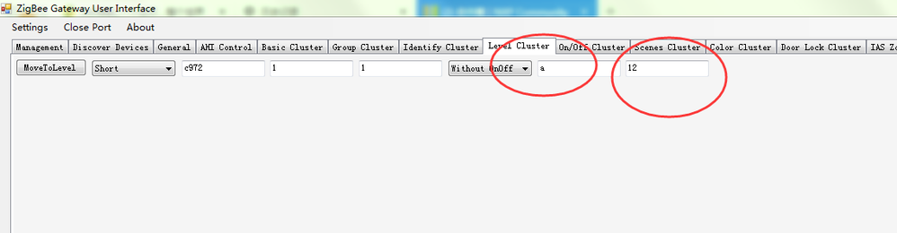

yuboli
hi  Felipe Garcia
   I adjust the duty cycle process, there is a time gradual process, the time is about 3s; why does it look like a few times when the brightness is low? My minimum gradient is 1;pastedImage_1.png

FelipeGarcia
Hi Daniel,
I tested this on my side and I couldn’t see this behavior. I changed the duty cycle from around 50 to 90% and the LED didn’t blink.
From what I understand, when you change the duty cycle, the LED blinks a few times before the duty cycle is updated. The PWM is working fine but there are some flashes at the beginning of the process.
Am I correct?
