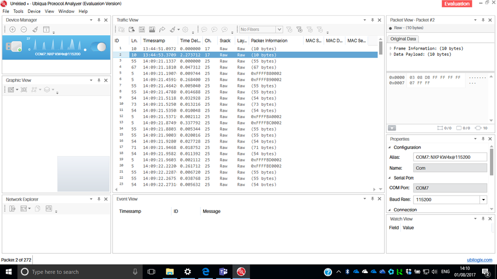

That's as far as I went before removing the NXP software and installing an evaluation copy of Ubilogix Ubiqua Protocol Analyzer to check if the USB-KW41Z could also sniff 802.15.4 packets. That appears to work, too!
More confirmation that the USB-KW41Z is programmed with the sniffer and is functional.
Note that this and the earlier Wireshark output were produced on a borrowed laptop running Windows 10 Enterprise (64-bit), Version:1703, Build: 15063.483 with all recent updates applied.

johnconnett
Just tried the evaluation of Ubilogix Ubiqua Protocol Analyzer Version 2.0 (Build 0103) on the original laptop and the USB-KW41Z works fine in both USB sockets. It appears to talk directly to the COM device using the Microsoft driver (Version: 10.0.15063.0; Date: 21/06/2006) rather than a virtual network interface. Looks like Kinetis Protocol Analyzer Adapter has problems on some Windows systems but not on others. No idea why ...
