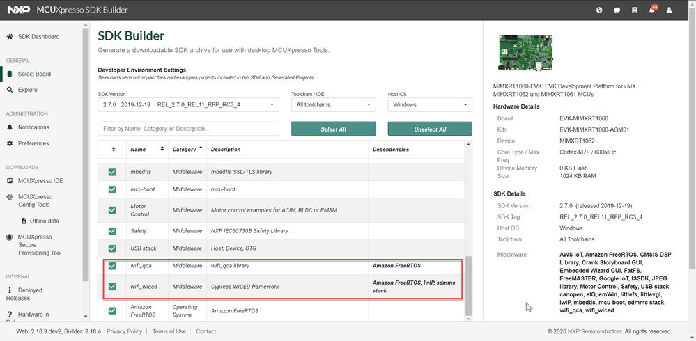

We are looking at making a simple gateway router based on the IMX RT1060 with Ethernet + a 4G modem connected to the USB and Wifi AP.
We believe we have everything under control using uTasker / FreeRToS for all the product requirments other than the WiFi.
The thing we need help with is implmenting a WiFi AP on the IMX RT1060 so people can use the WiFi as their gateway. We have no inhouse expertise on this and dont have hte time to "start from scratch" so we're looking for a quick solution to market.
Are there any non linux application examples for this type of solution based on C Code? Or possibly if you're an engineer with real experince in this exact area and have done this previously (outside of linux) maybe you can inbox me and we can have a talk about contracting this section of the design out

Hello Carl,
I highly recommend you to check our SDK examples we have available. We have some examples using Cypress Wi-Fi devices.
You can download the SDK in the following link:
Welcome | MCUXpresso SDK Builder
Felipe

Can you be a little more specific? The link just took me to the SDK builder, I have no idea where to go from there to find a WiFi AP solution?

Hi Carl,
I am sorry for the late response. You will need to build SDK for i.MX RT1060 EVK. Please make sure you include the related middleware as it is shown in the below image.
Once you have downloaded SDK I recommend you to check the following videos.
MCUXpresso IDE - Importing MCUXpresso SDK | NXP
MCUXpresso IDE - Importing SDK Example Project | NXP
