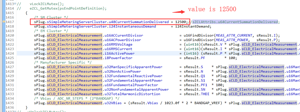

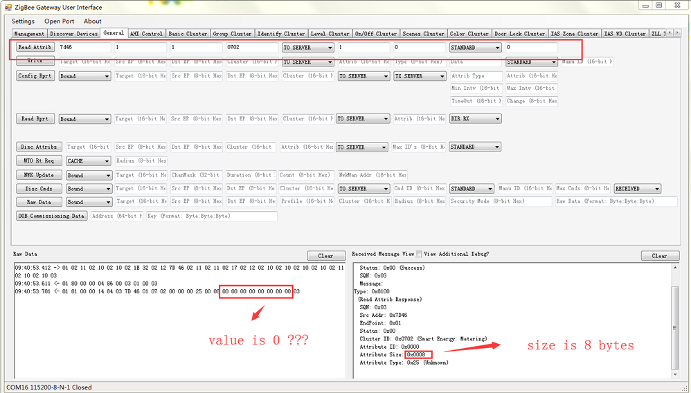

When i read u48CurrentSummationDelivered attribute of Simple Metering Cluster, the return value is zero
 here is my code:

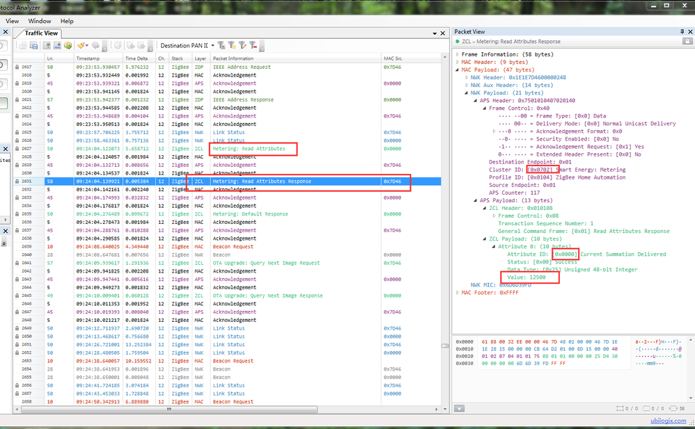

here is my Capture log:
Why is it not 12500?

Hi Daniel, I hope you're doing well!
Could you please try with the raw data command instead of the read attributes command? Is it sending the expected data in raw form? Or is it also a 0?
Please let me know of your findings.
