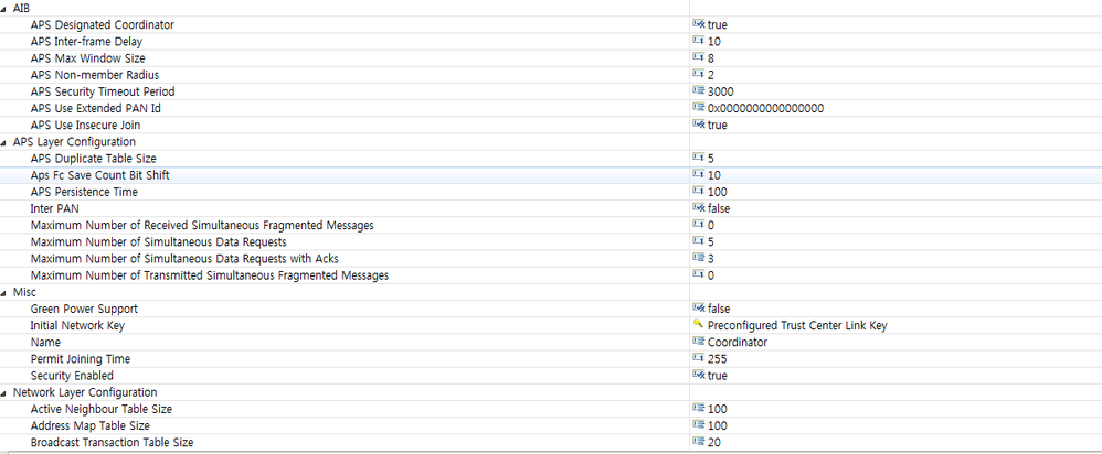

mario_castaneda
Hi Lee Wonsoo,
Could you please provide the set up that you have on the coordinator? Advance properties on the zpscfg file.
Mario

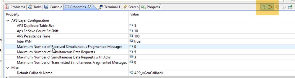

wslee
Hi Mario,
Advance properties is the following.
lee

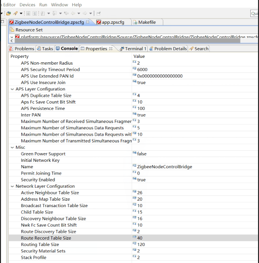

yuboli
Hi Mario,
I also encountered an error with ERROR: Extended status 0x87, because I connected more than 100 devices, this error will appear.
the following is the advanced parameter configuration of my coordinator in the zpscfg file
This problem has been bothering me for a long time, please help me
