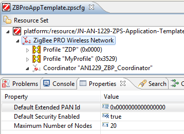

I built 6 End Devices boards based on JN5169-001-M00-2 module. End Devices are sleeping and wake up one time each minute.
Coordinator is USB Dongle DR1198 or eval kit DR1174 + DR1179 + DR1199 (same result on each).
I successfully connect 5 End Devices to Coordinator, but the 6th can't be connected at the same time, I need to power off one connected End Device (say the first) and wait coordinator to disconnect this first End Device to successfully connect the 6th End Device. Once 6th End Device connected, first End Device can't connect to Coordinator.
The result is I can connect many End Devices (say 10) but I can only run 5 End Devices at the same time. Others are disconnected from Coordinator.

Network should connect 20 End Devices.
1 - How can I increase End Devices running at the same time ? Where are parameters ?

Hi Pierre,
1 - How can I increase End Devices running at the same time? Where are parameters?
Select the advanced properties and be sure the Child table Size and the discovery neighbour table size have the value that you want.

pierrelgcb
Hi Mario,
1 - Thanks, it works. I didn't see advanced properties tab.
