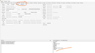

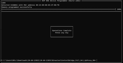

dmsherazi
Although it worked for me for the JN5168 module nut when I tried with DK6 kit , and used firmware
Following your instructions
As mentioned in JN-AN-1216 User Guide, section 4.2.2, Control bridge starts as a Coordinator.Instead of
  1. Then I set the device type to ROUTER
  2. Now I restart the Control Bridge Device that should work as a router
please try Erase PD > Set Type to ROUTER > Start Scan,without resetting the device.
I get this error when I press the start Scan button on ZGWUI

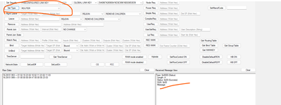

dmsherazi
Any ways the detailed issue is like
I have used JN-AN-1216 for the router control bridge made  changes to the build variables to build for JN5168 and built ZigbeeNodeControlBridge_JN5168_GP_Proxy_FULL_FUNC_DEVICE_115200.bin firmware , uploaded to the router module.
Now I use ZGWUI and do the following
  1.  Set Up COM PORT
  2. press get version button and I get reply as followsdostshah_0-1671625739885.pngdostshah_0-1671625739885.png
  3. Then I set the device type to ROUTER
  4. Now I restart the Control Bridge Device that should work as a router
  5. Now on my ControlBridge that is having the cordinator firmware , I would set permit join to true for about 3 minutes
  6. On ZGWUI which is controlling the JN5168 Full function control bridge and set type as router I press the Start Scan button.
  7. This should in my knowledge put the Router Control bridge in Network Search mode and the Cordinator should be able to add it , But I dont see any device announce on the Cordinator. If I would put any other zigbee device in network serach mode it will get added
