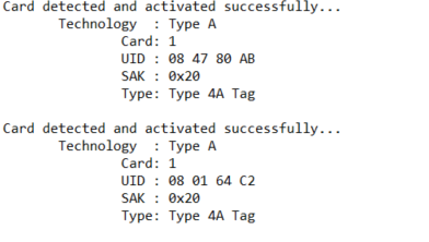

I am trying to read my phone UID using the DiscoveryLoop Example That NXP provides. But I am getting different UIDs. How can I identify my Phone other than the UID ?

Hi @amighri ,
If your Smartphone may simulate itself as some kind of tag/card, the PN7462C running the demo of "NfcrdlibEx1_DiscoveryLoop_mcux" may be used to detect the phone.

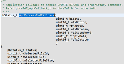

The demo supports both both reading and writing of NDEF message but doesn't check the content of message and toggle a GPIO accordingly ,  so you have to implement it by yourself.
The AppProcessCmdCallback() is used to handle UPDATE BINARY and proprietary commands, and you may add your own implementation in it.

Hi @amighri ,
Do you mean let the PN7462 print the content of the received NDEF message via the console such as UART? if so, you may refer to "uint8_t aNdefFile[1024]" at line 96 of "NfcrdlibEx8_HCE_T4T.c", which is used to store the NDEF message, and you may print it when this file is updated by the write operation.
