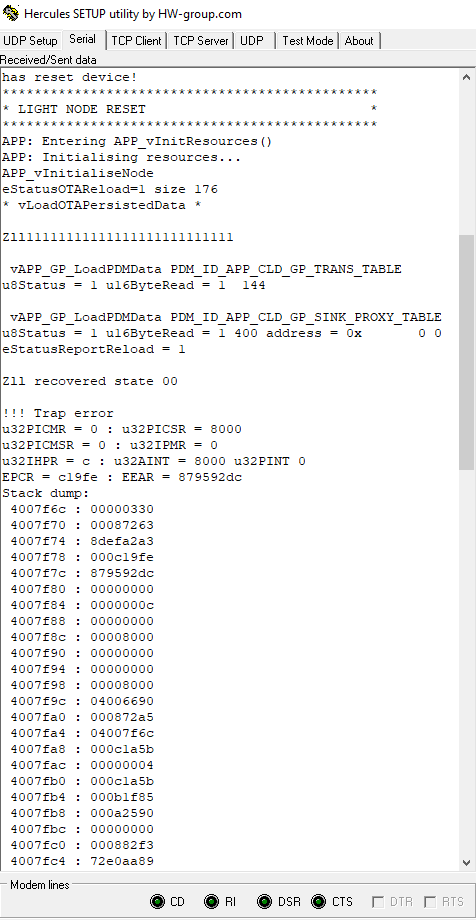

Now I'm working with JN-AN-1218-Zigbee-3-0-Light-Bulb. But I get a ploblem.
When I update OTA to DimmableLight note have 1 endpoint , It work well
Then I haved added another Endpoint, It work well with normal firmware. The problem occurred when I uploaded the OTA firmware. Router can't join to network
Can you help me !!! Thanks

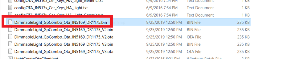

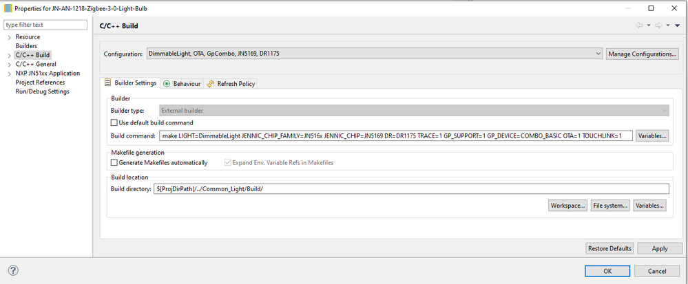

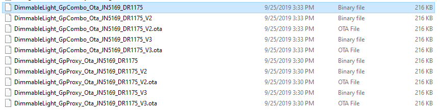

Just to clarify, did you change the build configuration to enable generation for new OTA files?
Could you please verify if new OTA files are being generated during the compiling process?
Please let me know of your findings.

minhtan_uet
Dear Sebastian Delrio Employee
Thank for reply :smileygrin:
I have try. But it still get crash and reset.

Sebastian_Del_Rio
Hi Tran Minh Tan,
If I'm understanding correctly, you programmed your device with the full OTA binary with only one End Point, then you sent the OTA upgrade with two End Points, and when the device reset, it crashed, correct?
Does the device also crash if you program the OTA binary directly instead of sending the .ota file to it?
