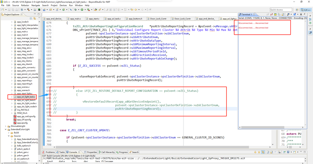

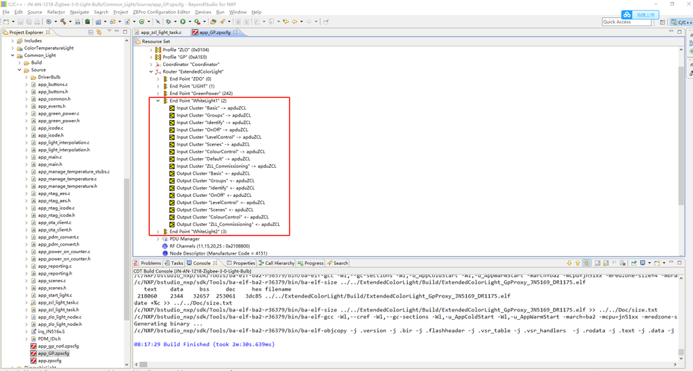

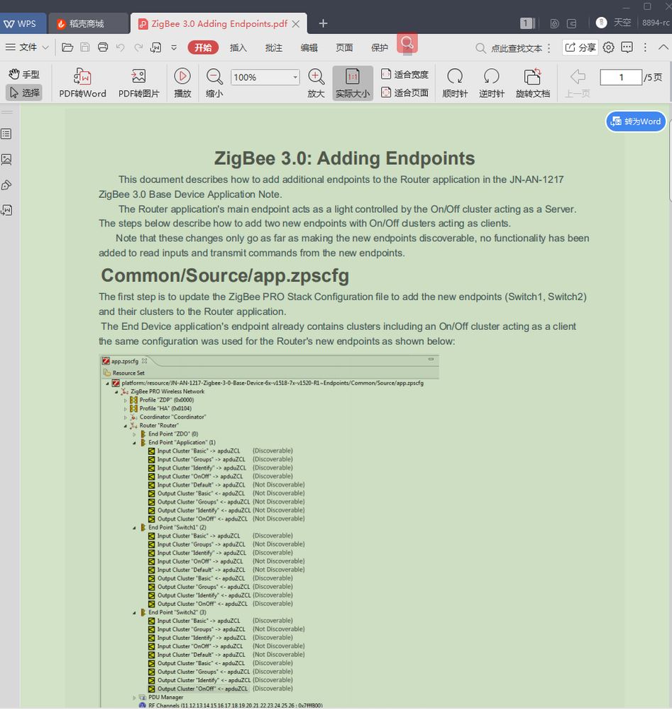

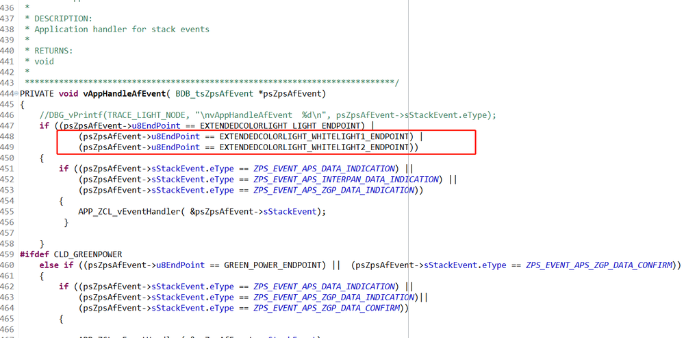

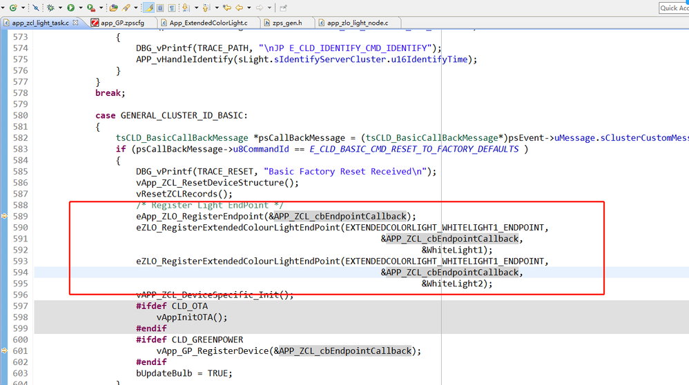

Hello, I have a problem now, which means I am confused.A problem arose when I added a new endpoint to the ExtendedColorLight routine of jn-an-1218-zigbee-3-0-light-bulb.After completing the configuration in files app_gp.zpscfg and zcl_options.h, and then completing the registration of defining device type and endpoint in files app_extendedcolorlight.c and.However, after I blocked the registration of defined device type and endpoint in app_extendedcolorlight.c and.h files, the file was successfully recompiled, and the data and initialization data were output in Terminal again.Now I'm depressed why is that? I used to add new endpoints like this?

Hello, thanks for your reply!I just added the new endpoint in the extendedcolorlight routine of jn-an-1218-zigbee-3.0-light-bulb routine according to the document provided by the government. After the addition, there was no error in the compilation, but where I printed the output, there was no output, and there was no initial output. I don't know why.1.png2.png3.png4.png5.png6.png7.png8.png9.png10.png

Hello, I opened a terminal in the last picture above, which is also marked.The other pictures are the code I added the endpoint to.My problem is that after adding a new endpoint to the source code above, I find that the terminal has no output of any information, including initialization information.

mario_castaneda
Could you please comment the next code app_zlc_light_task.c?
           /* else if(E_ZCL_RESTORE_DEFAULT_REPORT_CONFIGURATION == psEvent->eZCL_Status)
                vRestoreDefaultRecord(app_u8GetDeviceEndpoint(),
                                psEvent->psClusterInstance->psClusterDefinition->u16ClusterEnum,
                                psAttributeReportingRecord);
Also, could you please send an active request from the coordinator and wait for the response?

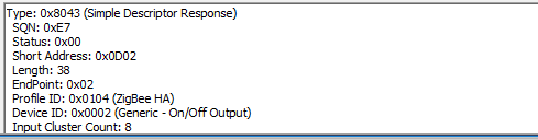

I ran some test by my side adding an endpoint. I sent a simple descriptor request to the endpoint 2.

Thank you for your reply.Strange, then, why can't I add endpoints.Can you share your test code for adding endpoints with me?

Please see the files that I modified. See my comments [MC]

Hello, thank you very much for your reply. According to what you said, I blocked that piece of code. After successful compilation, it will still be the same as before.The terminal outputs nothing, so it can't get into the network, and there's no way to send a request through the coordinator.Now I have a request, hope you can help me, can you help me to do a test, in Jacqueline Nottingham - AN - 1218 - zigbee - 3.0 - light bulbs - the ExtendedColorLight source a new growth point, test whether the new endpoint is available, if you can use this endpoint, there is a problem that because this is my code, please share your new endpoint code.If your newly added endpoint doesn't work, you know where my problem lies.In addition, I did not find in the source code where the event information of Color Cluster was received and processed.Do you know where it is?
