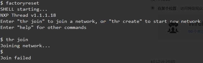

我导入低功耗终端设备示例(FRDM-KW41Z),并将THREAD_USE_SHELL更改为1,这是文件./source/config.h中的宏定义。然后,我输入命令'thr join'到shell,但它打印'join failed'。 pastedImage_1.png
当我使用ED示例时,我成功加入。
因此,我用嗅探器观察。我发现两个例子的加入请求已经达成一致并且交换了密钥。
为什么?

Which release and IDE are you using? Did you make any other change in the example?

I use MCUXpresso IDE v10.1.1_606 and import the example(thread_low_power_end_device).
I changed the macro definition THREAD_USE_SHELL in the file config.h to 1.
Then I type the command ‘thr join’ in the shell, but it prints out ‘join failed’.
I uploaded two sniffing messages, one was successfully added and the other was added by the example.

Based on shell log ( Thread version - 1.1.1.18), seems to be the same problem with the one from this topic : Thread low power end device examples can't thr join?
A new release including the fix for low power devices will be available at the end of July.
