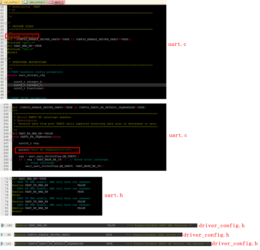

This function【UART0_RX_IRQHandler】is not running
2,845件の閲覧回数
zhengjung-hung
The chip is QN9021
This demo code from 1.3.9 QPPS
But I test 1.3.6 QPPS is OK
Other device Baud is 9600
In app_config.h,【#define QN_DEMO_AUTO             1】,I take out the notes,this code is running
I don't understand how this could happen?

zhengjung-hung
Same hardware,Download two HEX to chip
【1】1.3.6 qpps demo
【2】1.3.9 qpps demo
I didn't change the code
Receive UART data
1.3.6 is normal(Enter function 【UART_RX_IRQHandler】),but 1.3.9 is not

Hi Zheng,Jung-Hung,
I was checking the uart driver, could you please comment the if(UART == QN_UART0 line?
This condition never will be 1.
Be Sure that the CONFIG_UART0_R/TX_ENABLE_INTERRUPT is true and the UART_R/TX_DMA_EN is False.
#if CONFIG_ENABLE_DRIVER_UART0==TRUE
    //if (UART == QN_UART0)
        * Set UART config:
        * - oversample rate is 16
        * - HW flow control disable
        * - 1 stop bit
        * - parity type unused
        * - no parity
        * - bitorder = LSB
        reg = UART_MASK_UART_EN         // uart enable
            | UART_MASK_UART_IE         // uart int enable
            //| UART_MASK_CTS_EN
            //| UART_MASK_RTS_EN
            | UART_OVS16
            | UART_MASK_LEVEL_INV
            | UART_MASK_BIT_ORDER;
        uart_env = &uart0_env;
        #if CONFIG_UART0_TX_ENABLE_INTERRUPT==TRUE && UART_TX_DMA_EN==FALSE
        // Enable the UART0 TX Interrupt
        NVIC_EnableIRQ(UART0_TX_IRQn);
        #endif
        #if CONFIG_UART0_RX_ENABLE_INTERRUPT==TRUE && UART_RX_DMA_EN==FALSE
        // Enable the UART0 RX Interrupt
        NVIC_EnableIRQ(UART0_RX_IRQn);
        #endif
#endif‍‍‍‍‍‍‍‍‍‍‍‍‍‍‍‍‍‍‍‍‍‍‍‍‍‍‍‍‍‍‍‍‍‍‍‍‍‍‍‍‍‍‍‍‍‍‍‍‍‍‍‍‍‍‍‍‍‍‍‍‍‍‍‍‍‍‍‍
Let me know you findings
Mario
