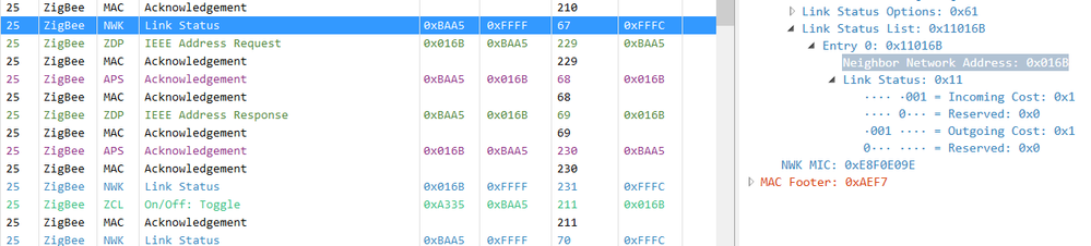

We used JN5169 to make a light control system,but now I found a problem, sometimes, the button can not control the light.Packet capture found that the button sent the command to the route, but the route did not forward the command to the light.
As the picture  shows,The button is 0xF60B,the route is 0xAE3D,the light is 0x6F6D.
Can you tell me what caused it,thank you!

For any reason, the Route 0xAE3D is not finding the light 0x6F6D. The route is not available, I am not sure if the 0x6F6D is not near from the Zigbee Network.
Is the 0x6F6D power on?

The 0x6F6D keep power on,the 0x6F6D is near from the Zigbee Network.The control can be restored by repeating the power on and off several times.

Is the device in running mode? The sniffer log shows that the 0x6FD6 is not available.
Is it possible that you could send a simple command through the TC?

I submitted a new sniffer log,As the picture shows,The button is 0xA335,the route is 0xBAA5,the light is 0x016B.
The link Status show the  nighbor network of 0xBAA5 has 0x016B,but the 0xBAA5 did not forward the command to the 0x016B.
After the button is powered on and off again,it can forward the command to the 0x016B.
So Is it caused by a button or a route?What caused this?

The 0x016B device doesn't have any endpoint 1. What is the example that you programmed on this device?
What is the AN that you are working on these devices?

     Sorry for taking so long to reply to you.The equipment runs a modified program based on JN-AN-1217,We registered two endpoints, corresponding to two lights.Do you mean that the router cannot find the corresponding endpoint, so it cannot forward the message to the device?But why most of the time it can find the corresponding endpoint.

Is it possible that you could print the routing table of the router devices?

The coordinator uses JN-AN-1216, the light is modified based on the JN-AN-1217 router, the eZLO_RegisterDimmableLightEndPoint is used to register two endpoints, endpoint 1 and endpoint 2. The button is modified based on the JN-AN-1217 EndDevice,used eZLO_RegisterDimmerSwitchEndPoint to register endpoint  .We all observe the router's routing table from the sniffer log.

Please accept my apologies for my late response. I have been checking your sniffer log. It is very interesting the reason why is the route is not forwarding the message. I want to confirm and understand the issue that you are facing.
Is it possible that you could print out the APS table in your router?
Is there a reason why in your sniffer log the coordinator sending messages?

   Thank you very much for still remembering this question.Since this light is installed on the ceiling, it is not easy to print its APS table.I don't see in the  sniffer log that the coordinator you are talking about is sending a message.At present we plan to rewrite the program.See if there is the same problem.Finally, thanks for your help.

Is it possible that you could read out the routing table after the issue happens?
vDisplayRoutingTable()
The API is defined in the appZpsExtendedDebug.c
C:\NXP\bstudio_nxp\sdk\JN-SW-4170\Components\ZigbeeCommon\Source\appZpsExtendedDebug.c
Let me know your findings.
