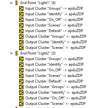

@Ricardo_Zamora  I was trying to add an endpoint.
What I want to acheive:
  • Use JN-AN-1247-Zigbee-3-0-IoT-Control-Bridge AppNote as a Router with three ON_OFF Loghts connected
  • Endpoint 1 will be as it is , EP 4,5 and 6 will be lights with clusters ( scenes , groups, on off and identify) implemented on each
What I Have done so far:
  • Added the three Endpoints to the zpscfg file.
  • Modified the ZclOptions.h to include the ON/OFF server cluster and reflect the endpoint counts.
  • Modified the  tsCLD_ZllDeviceTable sDeviceTable to refelct the 3 new endpoints.
  • Call   eZLO_RegisterOnOffLightEndPoint  for the 3 new endpoints.
Problem:
So after all the above , the endpoints are implemented and I can send ON/OFF commands and get the Attribute Read responses but with One issue. If the source endpoint is not same as the destination endpoint I dont see any responses. Only if the source and destination endpoints are same then I can recieve teh ON/OFF command or the Read attribute

Where am I doing something wrong? I deally I would be able to send the requests of commands and attribute reports from Ep 1 of the control bridge as it as the ON_off client cluster
2,855 次查看
dmsherazi
@Ricardo_Zamora  or any one can help sort out this issue ?
When Using ZGWUI , when I send request from src endpoint 1 to destination endpoint 4 or 5 or 6 , I get Zigbee error code 0x06
But when I use the src as 4 and destination 4 , or both as 5 or both as 6 its successfull
