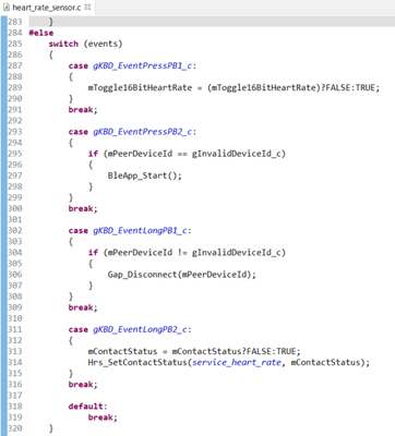

I am using KW38 evaluation board with heart rate demo code so how can we start Ble app (BleApp_Start()) without switch ?????

Hope you are doing well. The objective of the example is not only to use the function BleApp_Start();. You can see in the function BleApp_HandleKeys() that we have four functionalities with the buttons.
But if you don't want to use the buttons, and the other functionalities of the example, what you can do is call the BleApp_Start() function inside the main_task() function, on the line before App_Thread (param);
Hope this helps.
