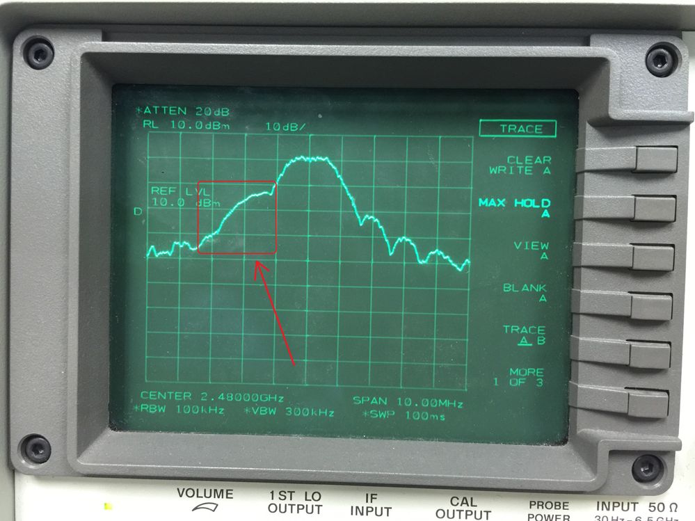

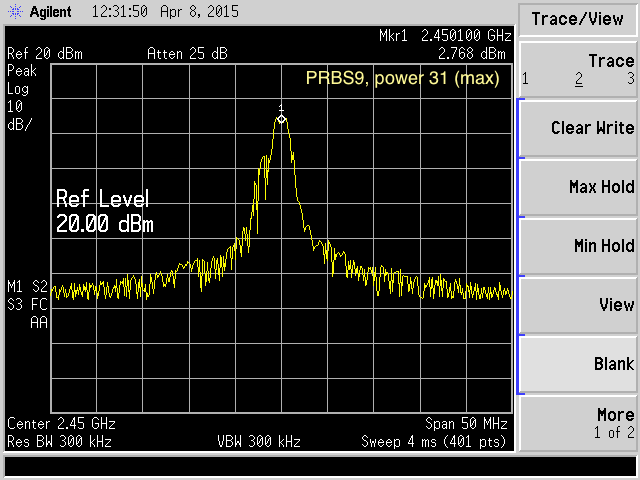

We have serious issues with a MK21D512 based transceiver: apparently the chip is generating spurious signals when switching to/from transmit mode. This leads to a substantial reduction in permissible power to achieve the FCC mandated adjacent channel attenuation as well as the Band-edge compliance. Our transceiver uses a FE + PA from Skyworks to achieve the 20 dBm output power. However, to eliminate other sources we measured the output of the bare-bone Freescale TWR-KW24D512 demo board, using the standard Freescale "Connectivity Test" software, with no amplifier (the board "as is"). Using continuous carrier modes (modulated or unmodulated) all parameters pass, however in PRBS9 mode where the transmitter switches on and off before and after each sequence sent, the issues are clearly visible. Attached are four snapshots that demonstrate the issue: first three are in PRBS mode at minimum (3) and paxiumum (31) power levels, and one image with a continuous modulated signal at maximum power. All images are taken with the spectrum analyser in Max Hold mode, after about 30 seconds of sampling the data.
Does anyone else found similar issues? Are there any solutions to this problem? Maybe with a different initialisation of one or more of the multitude modem registers in the chip?

We are currently investigating this, this issue seems to be more visible when using an external PA the standalone boards are FCC pre-qualified.
As described above, the "spurious signals" are being presented as switching transient that is just 10's of ns wide, only noticeable when using Continouos PRBS9 test and leaving the MAX Hold on the Spectrum Analyzer for more than 30 seconds.

I have been looking at a transmitted signal today.
I also notice something similar in MAX-hold mode.
I then tuned the spec analyzer off 20 MHz and set it to zero span and I do see a switching transient that is just 10's of ns wide. Its not clear if this is created in the spectrum analyzer or part of the transmit signal, it appears as though the rising edge of the transmit signal is also very narrow/fast. So this could be a switching transient caused by fast rise time.
I am reviewing with others here to see if there is a registers setting or other provision to adjust the rise time or some other explanation for this issue.

We also thought at first that this might be an artefact of the Spectrum Analyser, but the matter of fact is that the test house that tested our device for FCC compliance found the same issue and they classified our device as not compliant at the band edges. Basically what they said is that we can only use the device if the output power is set at 0 dBm for channels 11 and 26 and 6 dBm for channels 12 and 25. Channels 13 to 24 can be used at full power (in our case 15 dBm). And this is quite annoying as we've basically lost at least two channels.

     I also have the similiar question like Lix described.  I just used KW20 EVB and load connectivity test code running with PRBS9 mode, CH26, Power set to 30, set max hold at spectrum analyzer. I got below test results. Any comment ?

However, I have no doubts that the board itself is 100% FCC certifiable, because of its relative low power output. If you attach a 20 dB amplifier after the chip, then the spurii will be also amplified to such an extent that some parameters as e.g. Band-edge compliance will not pass (we use the Skyworks SE2436L, our goal was to reach at least +20dBm output). The net effect was that we are forced by the test house that did our testing to reduce the maximum power to +15 dBm and at the edge band channels (11, 12 and 25, 26) to +1, respectively +6 dBm. At least for these channels, it defeats the use of an amplifier! The problem is that the Band-edge compliance test specifies absolute values and not relative to the carrier level.
Please note that from the diagrams above the spurious signal levels are about 10dBm over the baseline (modulated or unmodulated continuous carrier). This is in fact the amount of power lost in in order to pass the FCC's Band edge compliance test.
Anyway, to evidence the issue is very simple, just hook the board to a spectrum analyser, switch it to PRBS9 transmit mode: you will see the occasional peaks jumping around the carrier. If you switch the spectrum analyser to hold mode, after 30 seconds or more you will see the baseline growing with about 10 dBm. This does not happen in TX continuous mode, both modulated or unmodulated. Clearly, the transmitter switches the internal PA too early (or too late when the T sequence is done), before the PLL is fully stabilised, or maybe there is a pulling effect on the PLL when the internal PA is switched on. Our hope was that Freescale knows about this issue and that there is maybe a modem register that can be tweaked to eliminate, or at least attenuate this effect. Otherwise we will have to look elsewhere to other competing solutions. It is rather disappointing as we have already invested quite some time and money in this project.
