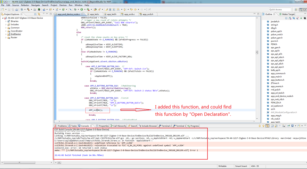

quanjunzhang
I added a function, but there are some trobles in compile.
Please give me some help.
Thanks very much.

quanjunzhang
Hi Mario,
I had defined the prototype function. And the c file  has a .h file with the prototype function.
Below is my screenshot. Can you help me check it?
thank you very much. I have spent a lot of time.
Zhang

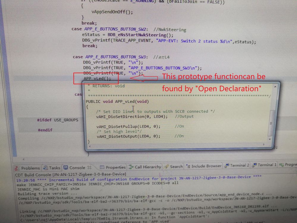

quanjunzhang
Hi Mario,
I just created the app_led.c and app_led.h files and define a function under the new folder, then called the function in app_main.c. This will cause a compilation error.
BUT, if I define the same function under the existing folder (app_end_device_node.c), then called the function in app_main.c. This will be no error.
Is this because the .c.h file I created requires additional system configuration?
Please give me some accurate advice, I have spent too much time to solve this problem, thank you very much.
Zhang

quanjunzhang
Hi Mario,
I have tried all of them, but the error is still there.
Can you accurately mark it on the screenshot I sent?
I know this is a very simple question, but it has been bothering me for too long.
Or I exported the project, can you help me check it out?
Zhang

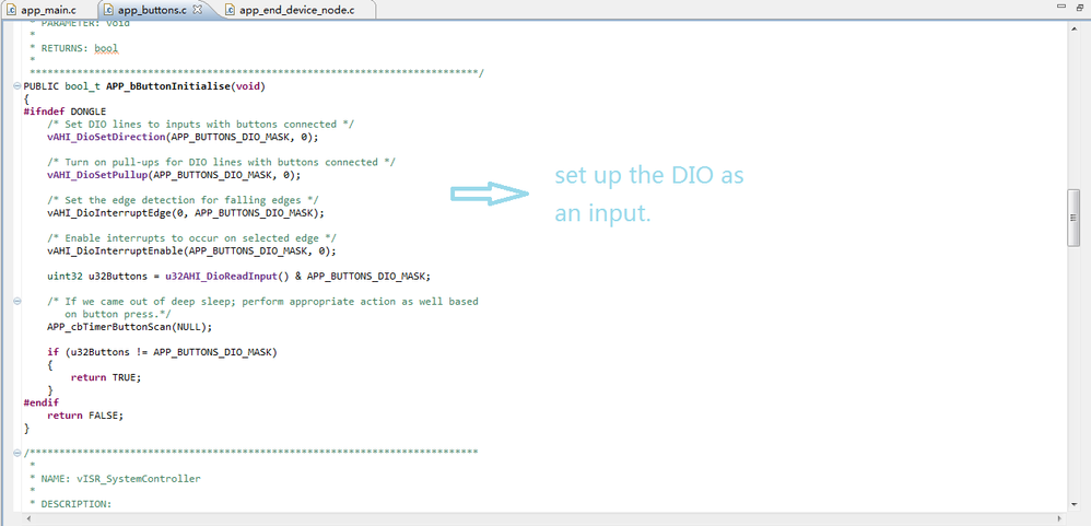

quanjunzhang
It is OK now.
The application notes has set the  DIO as an input and  created an event for the button 3.
