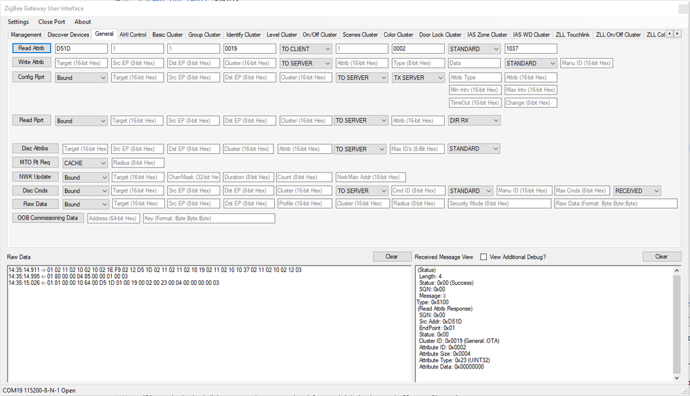

Hi all,
I facing a problem when I query file version, manufacture code, image type of JN516x device.
I work on JN-AN-1218-ZigBee-LightBulb and using ZGWUI tool for coordinator. With basic attribute, such as ManufacturerName, DateCode, ModelIdentifier, etc, I query normaly, but with OTA attribute, I can not.
anything wrong?

I also use the DimmableLight application, but I always get value 00 00 00 00. I just read attribute 0x0002 of cluster 0x0019.

I using JN-AN-1218-Zigbee-3-0-Light-Bulb version 1008 and JN-SW-4170 for SDK. I tried to delete and download AN again, but I got the same result.
Below is the photo when I read attribute FileVersion (0x0002) on Cluster OTA (0x0019).Capture.PNG
7,398 Views
mario_castaneda
Hi Giau,
Could you please change the Client Attribute? The frame is  0 - from server to client.
In this case, the control bridge is the OTA server and the client the dimmable light.
Please let me know your findings.
Mario
