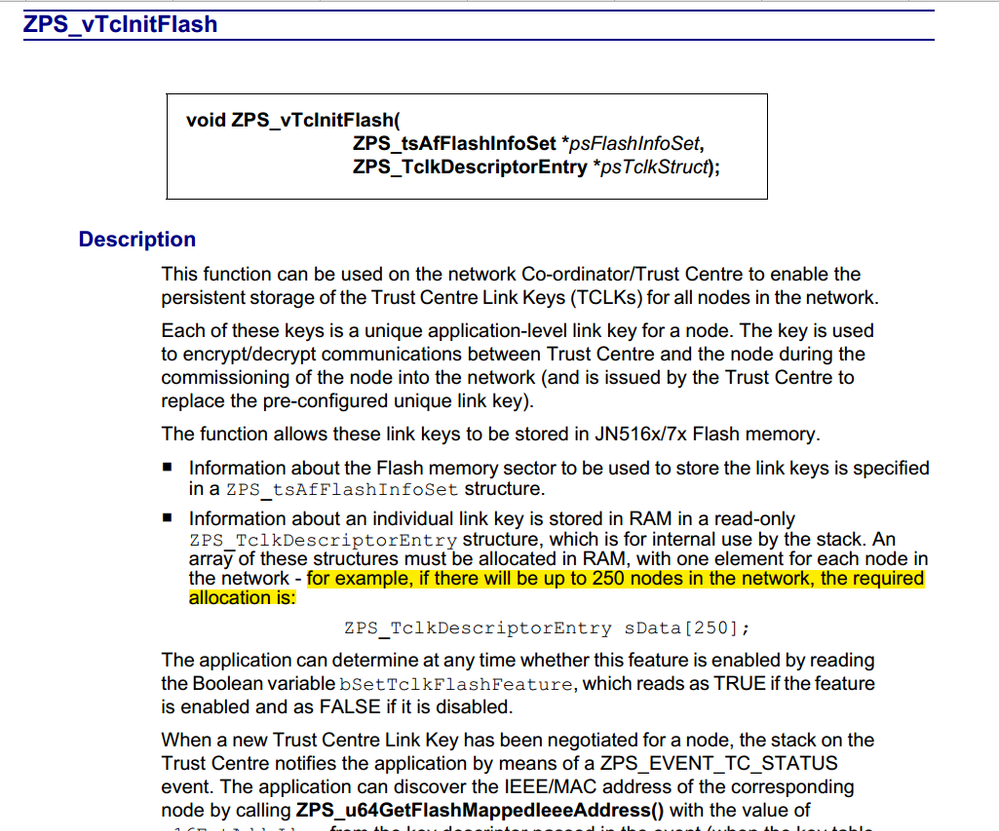

sdk version:1745
stack version:zigbee 3.0
coordinator project:JN-AN-1216, version:1010
In JN-AN-1216 coordinator project,the default value for macros ZNC_MAX_TCLK_DEVICES(app_common.h) is 20.
I learned about the meaning of this value in the manual ZigBee 3.0 Stack User Guide Revison 1.2.
Now the value is 20, which means that there are only 20 nodes in my network at most.
Q:
I have 1 ZR and 19 ZEs. And all the devices have joined the network. Now, the one node(node A) of the 19 ZEs, whose direct parent is ZR, leaves the network on its initiative by pressing a button for long time.Then, other new node(node B),not int 19 ZEs, want to join the network.But the node B has failed to join the network all the time.Why?
Strangely, device A can successfully join the network again.Why?

Hello Erlei, I hope you're doing well,
First of all, I'm really sorry for the delay on my response.
To solve the problem you're having, you'll have to change one of the functions located inside the
App_Znc_cmds.c source file:
  • You'll need to delete
bCredPresent = zps_bGetFlashCredential ( u64DeviceAddress, &uKey, &u16Location, FALSE, FALSE );
From the APP_bSendHATransportKey function in that file, as well as change the if condition from:
if ( ( bSetTclkFlashFeature) ||
( u8Status == 1) )
To:
if ( ( bSetTclkFlashFeature) &&
( u8Status == 1) )
And remove this credential check:
/*If credential is present roll back to confirm that key is used and not install code */
if(bCredPresent)
asTclkStruct[u16Location].u16TclkRetries = 0xFFFF;
