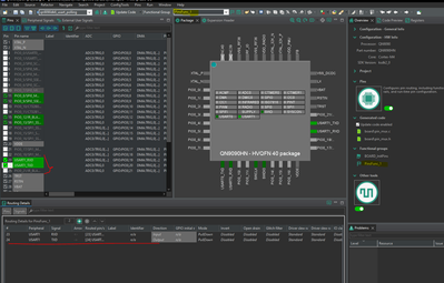

Hello there,
I am using the BLE example design "private_profile_server" and I would like to add a UART communication to the design.
After removing the default pins configuration for the UART_1 on (pins11-10) and the SPIF (pins17-21) , I set-up the pins for the UART_1 at pins 19-20

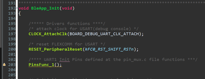

I found out the problem was due to the HW pin initialization not being applied.
After updating the pins via the MCUXpresso 'Config Tool' using my own Pins Group = PinsFunc_1, the function created by the tools with the new pins configuration needs to be called on the SW App code.
Calling the additional UART pins configuration on the code
