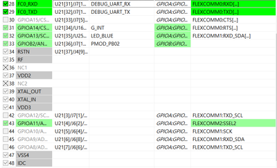

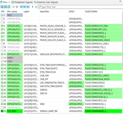

I try to do data transmission through QN9080cdk using SDK example: "qn908xcdk_wireless_examples_bluetooth_private_profile_server_bm". I works fine, and USB dongle get data well.
Now I want to do this work in my own PCB board which MCU(QN9080) is mounted. To do it, I refer the pin setting of "qn908xcdk_wireless_examples_bluetooth_private_profile_server_bm", but I found that the RF pin is not used. How QN908xcdk board can send the data wirelessly to USB dongle without using RF pin which is connected to antenna? Which pin is a {{really}} needed one to send data wirelessly?
Below is a default pin setting of above SDK example.
16,383件の閲覧回数
Ricardo_Zamora

Ricardo_Zamora
Hope you are doing well. As seen on the image, some pins are "enabled" by default, like RF, RSTN, XTAL.
Hope this helps!
Ricardo
16,507件の閲覧回数
mjkimbravo
Thank you your reply. The gray pins are the default, not disable.
Then here is another question.
When I debug SDK "qn908xcdk_wireless_examples_bluetooth_private_profile_server_bm" in my own PCB board, loT toolbox or connectivity QTool cannot find my MCU BLE device (it works fine when I tested it using Design Kit).
I didn't touch any code in SDK, except I add BleAPP_Start() function on main_task() to start task directly after debugging start without pressing a Button1 (because there is no Button1 in my own PCB board).
In my PCB board, I connect RF pin to inductor and antenna as manual said. The below is a schematic.
What I have to do more to wirelessly connect my own QN9080 in my PCB to phone or PC? Do I have to connect RF pin to any other pins? or which position I have to modify in the code?
