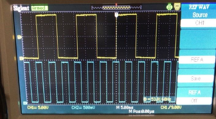

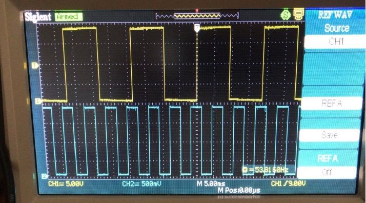

2) We programmed a CTIMER triggered interrupt to trigger the ADC to perform a single
sampling every T seconds (T is in the range of 2mSec down to 100nSec).
In addition,
Upon each CTIMER interrupt (which triggered ACD start sample) - we toggled 1st IO -
please find the BLUE channel in Picture 1 and Picture 2
Upen each ADC end of conversion (ACD ready status) - we toggled a 2nd IO - please
find the YELLOW channel in the Picture 1 and Picture 2
Our conclusions from the results are that the ADC conversion time is about 2 mSec (we
need 100uSec).

Picture 1:
Picture 2:
