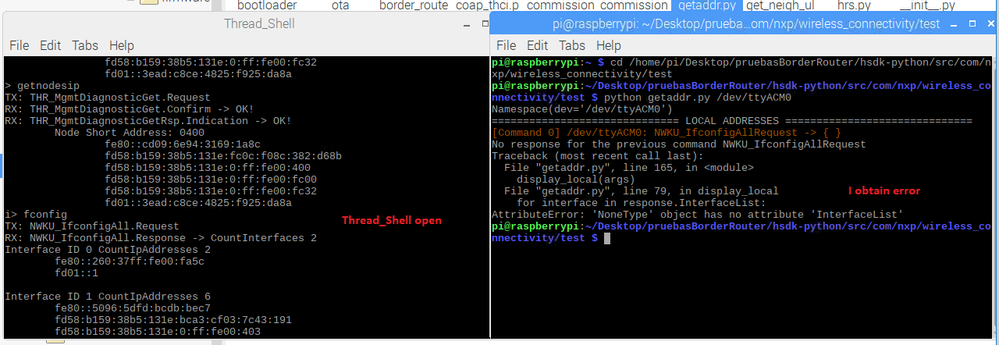

I watched in the hsdk-python folder (hsdk-python/src/com/nxp/wireless_connectivity/test) a script that get the address of the nodes (getaddr.py). The problem is that if I have the Thread_Shell open the getaddr.py script does not work, this is what appears:

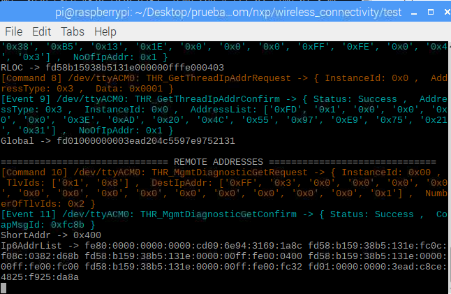

However, when I close the Thread_Shell I am able to obtain the addresses of the nodes:

The reason why you might be experiencing your problem it's most likely to be because both need the port to work, so you can't open both at the same time, nonetheless, you could try adding the functionality of the script to the shell one so you can use the shell instead of the python script.
