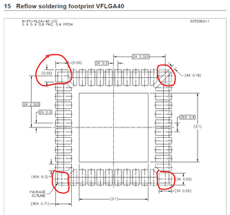

Fion
Hi Kelly,
Another question, PN5190B2HN VFLGA40 footprint have 4 thermal pad in the corner, what should i do? connnect with GND or left float? Many thanks.
