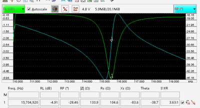

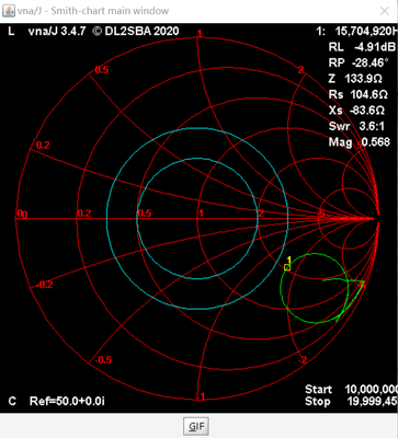

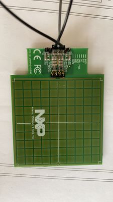

Dear Sir,
When I use the VNA to measure the PN5180 antenna, but the result shows:
The NanoVNA shows:
Return Loss: -5dB
Z =  133R @13.56MHz
Is the antenna matching result not good for PN5180? And how to solve it?

Hello Sir,
I'm sorry for the delay on answering this.
Please check our training videos about antenna design
https://www.nxp.com/video/nfc-antenna-design-1-which-antenna-for-what-purpose:WHICH-ANTENNA-PURPOSE-...
Also, you might find useful the document AN12810 guidelines for NanoVNA Antenna design
https://www.nxp.com/docs/en/application-note/AN12810.pdf
This document will provide useful guidelines to follow for antenna design for PN5180
https://www.nxp.com/docs/en/application-note/AN11740.pdf
Please feel free to share your findings to the community.
