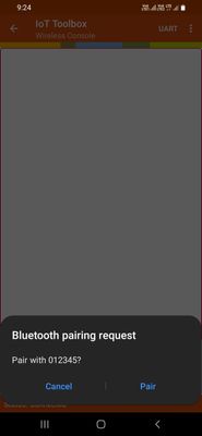

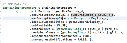

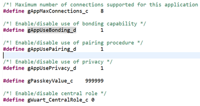

I am trying to Implement Number Comparison bluetooth method with MITM protection, as per the Numeric comparison method when pairing is initiated 6digit key should appear at the both end(mobile and device end) which is generated by RNG, when I am trying to connect I am not getting the 6 digit key and also pairing is not happening below are the changes which I had made in the wireless_uart code(BM) for pairing parameter
I have enabled the bonding and pairing info like below
Note :- I am using KW38 Controller and wireless uart BM example code
Kindly let me know what other changes are required which I have missed here, and also is it possible to get the bonded paired information. Kindly revert back the earliest

xing_chang
Hi @Javad_Baig ,
please change the IO capabilities to displayYesNo,
gPairingParameters.localIoCapabilities = gIoDisplayYesNo_c;
You can use Gap_LoadKeys() to read bonded info.

again when I try to connect with Device it is showing "pair" option without displaying 6digit key generated from RNG, and also I tried looking for the variable which stores the key generated by RNG in the device end I couldn't able to find it.
Please again look in to the configuration which I shared in the previous post and let me know if any further changes are required for Numeric Comparison Method
I have attached a screenshot for the same, her I have changed the device name to 012345, when I try to connect with this device directly it is asking for pairing option without displaying 6-digit number

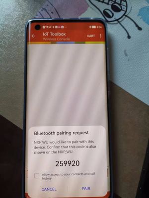

xing_chang
Hi @Javad_Baig
You need to press "PAIR" first, then the 6digit key is shown.

Javad_Baig
Hello @xing_chang,
Thanks for the reply, for me after click on "Pair", status is showing as connected, I am not getting that 6digits

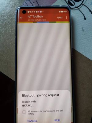

xing_chang
This is my test environment:
SDK: SDK_2_6_14_FRDM-KW38
Phone: Huawei Mate40E
Attach the modified files.

Javad_Baig
Hello, @xing_chang
I compared your file and did the same changes as yours, still it is the same. When I click on "Pair" it will get connected automatically without displaying 6 digits.
 I am using Samsung A30s Phone.
and also can you tell me which variable holds the 6digit key in the software end so that I can debug and check.

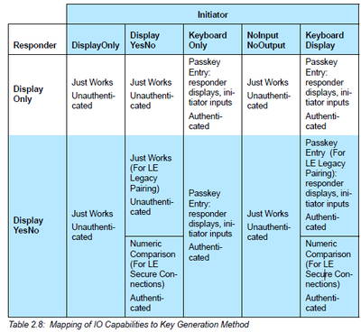

xing_chang
Hi @Javad_Baig ,

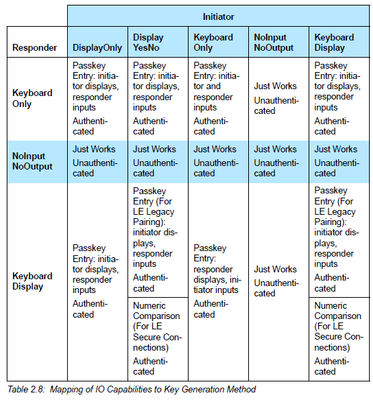

In the Core spec 5.0, there is a table as follows, the phone as initiator with KeyboardDisplay, and KW38 as responder with DisplayYesNo or KeyboardDisplay, it should be Passkey Entry or Numeric Comparison, I don't why it is Just Works on your side. Could you capture some air log?
