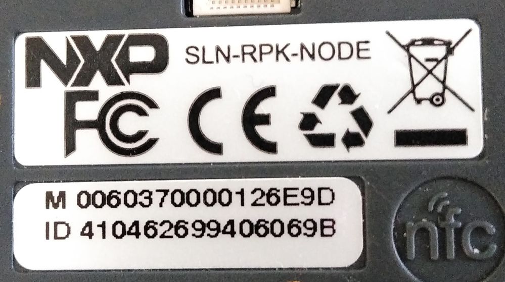

ralphxyz
Thank you Mario, the Rapid-IoT has never been connected with bluetooth, so it is not in the rapid-IoT studio!!
Occasionally I have seen a P6E9D on my phone bluetooth connection and on my computer but I do not know the password so I have never connected! I think I have to turn bluetooth off and reset then turn bluetooth on and reset
then I "might" see the P6E9D device but cannot connect!!
Ralph

ralphxyz
Hi Mario, thanks for the help!! I tried another Windows 10 computer and a Raspberry Pi, no USB I have a Windows XP Pro I'll try that.
Two questions:
Is the P6E9D device I am seeing while attempting bluetooth connection the Rapid-IoT device?
If so what is the Bluetooth password? Possible bluetooth will work, it would be great to be able to flash the device
but if bluetooth works I could at least still use the device.
Ralph

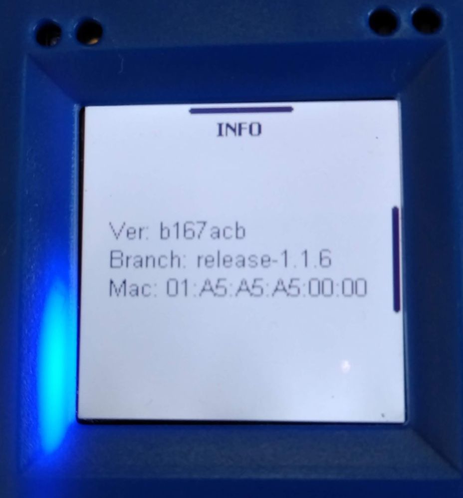

ralphxyz
I had tried the Rapid Iot Application but did not see any devices!
So I was trying just to connect to the device using standard bluetooth connection from my phone to the device
as you normally connect bluetooth devices. That failed also.
Eventually after multiple tries and resets soft and hard I eventually saw the P6E9D device.
I could not connect for lack of a password.
Now that I can see the P6E9D device I am try to use the Rapid IoT application.
It appears to be connecting BUT the output does not change the light sensor does not change when I cover up the device, the direction sensor output does not change when I move the device!!
The computer Cloud application shows the device which I select but it has no data!
Rapid IoT.png - Google Drive
Rapid IoT 1.png - Google Drive
Ralph
12,321 Views
ralphxyz
On my phone using the Rapid IoT application when I select the device there is a flashing bluetooth icon in the lower right corner of the screen this flashes for a while then the data from the various sensors appears and the flashing icon stops flashing. The icon never flashes again the data is not updated!!
