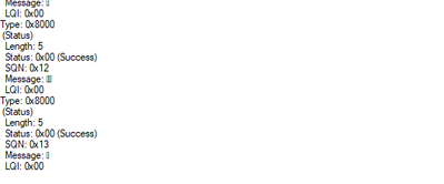

Hi ,
I try read Attribute but no see Attribute report. I have check and config on file reporting.c but receive not see Attribute report

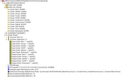

NgocHoangNguyen
Hi guy,
I have add Cluster Binary Input on app.zpscfg and app_reporting.c as below but only receive success (0x00) but not receive attribute report. I want to read attribute bPresentValue

Julián_AragónM
Hi @NgocHoangNguyen,
Please help me confirm you did include the file "BinaryInputBasic.h" into your project and follow the ZigBee Cluster Library chapter for this cluster, as well as chapter 19.3.3 (Attributes for Default Reporting), where it is explained default reporting for:
  • bPresentValue
  • u8AttributeReportingStatus
Also please help me look into both chapters 19.3.4 Functions & 19.3.6 Compile-Time Options.
Chapter 19.3.4 describes the function utilized to create an instance of the cluster in an endpoint, and chapter 19.3.6 includes optional and global attributes to enable and define.
I hope you find this helpful. Best regards, Julián.

NgocHoangNguyen
Hi ,
I have add include file BinaryInputbasic.h . And I call Initialisation as below but when I use ZGUIDE still not Atribute report . Please see help me ?
In the file zcl_option.h  I have enable #define CLD_BINARY_INPUT_BASIC #define BINARY_INPUT_BASIC_SERVER

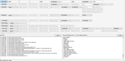

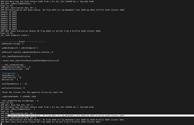

NgocHoangNguyen
This is my log when I debug it . I read attribute response but It return default response .
So how to resolve it ? Thanks

Julián_AragónM
Thank you for the images, could you please help me with a sniffer log (such as Wireshark or Ubiqua) of the network as well? This is to analyze and narrow down what is happening in the network and why is the cluster not returning attribute responses.
