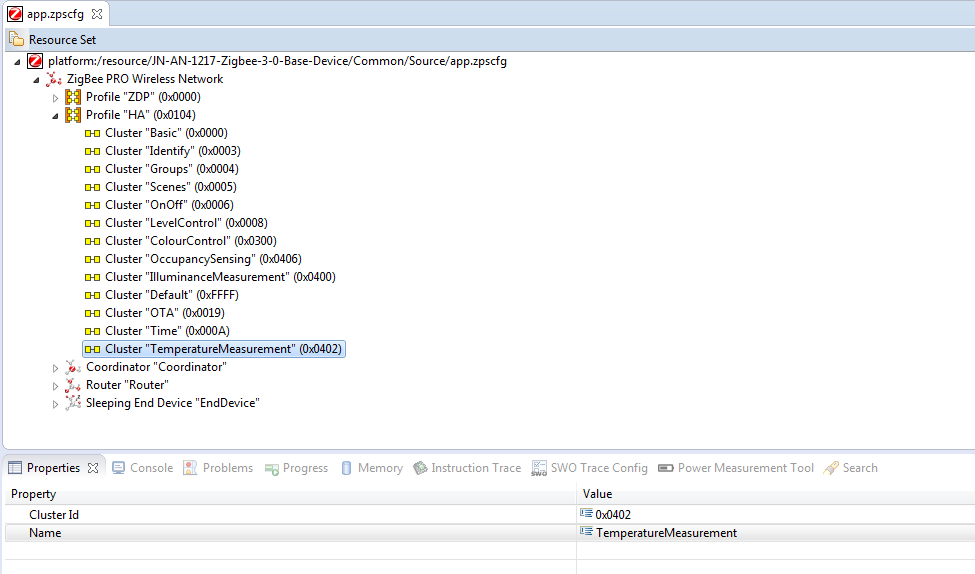

 Common/Source/app.zpscfg

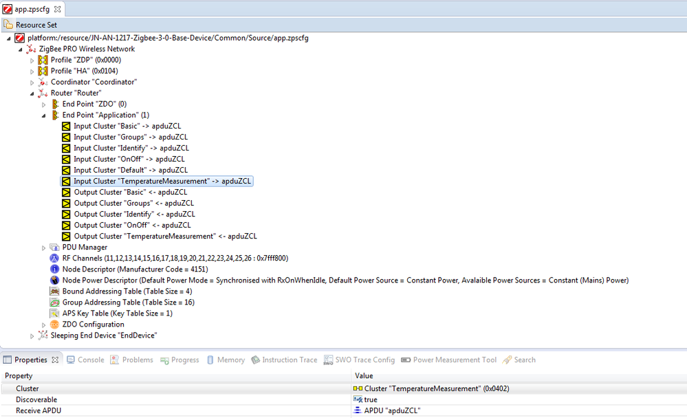

The first step is to update the ZigBee PRO Stack Configuration file to add the new clusters (OnOff Client, Temperature Measurement Server) to the Router application endpoint.
The HA profile already contains few clusters but Temperature Measurement cluster was added:
The OnOff client was already present in Router endpoint but the Temperature Measurement cluster was then added into Router application endpoint:

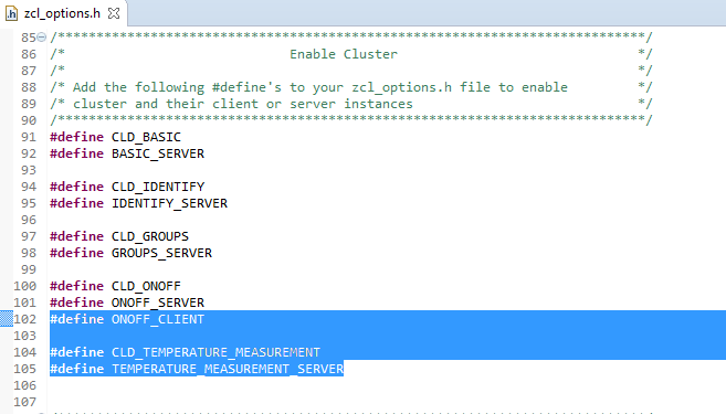

Router/Source/zcl_options.h
This file is used to set the options used by the ZCL.
Enable Clusters
The cluster functionality for the router endpoint was enabled:

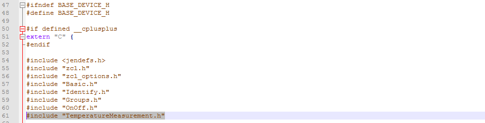

<Path to JN-SW-4x70 SDK>/ Components/ZCL/Devices/ZHA/Generic/Include/base_device.h
The first step was including the Temperature Measurement header files into base device header file as shown below:

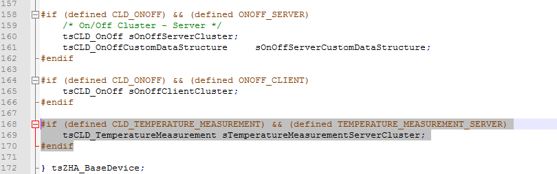

The second step was adding cluster instance into base device Instance as shown below:
The next step was to define the cluster into the base device structure as below:

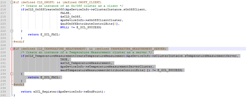

<Path to JN-SW-4x70 SDK>/ Components/ZCL/Devices/ZHA/Generic/Include/base_device.c
The cluster create function for Temperature Measurement cluster for server was called in ZigBee base device registration function:

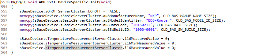

Router/Source/app_zcl_task.c
Temperature Measurement Server Cluster Data Initialization - APP_vZCL_DeviceSpecific_Init()
The default attribute values for the Temperature Measurement clusters are initialized:
