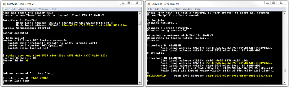

I've tried using the sockets in the shell demo (with two FRDM boards) as you mentioned in the previous thread, but I'm not sure how to tell if it's working. There's no receive functionality documented in the shell, and the receiving end doesn't present any kind of indication that it's received anything. I looked at the shell code to see if I could add the receive command, but there's no enum value for that command to be added to the pAppSockCmdParams.
I also tried using the shell to send to my custom board, which is set up to join a network, find a neighbor, open a socket, and start receiving. The behavior there is the same as when my custom board is the network leader sending data to the custom joiner/receiver: correct length, incorrect data.

The sockets on the shell should work fine, you just need to enable the "#SOCK_DEMO" macro and you should be able to open a socket to a remote node and send/receive udp packets; by default the receiver will listen on port 1234 (see #UDP_PORT). Documentation on how to use the socket demo is available at C:\NXP\MKW41Z_ConnSw_1.0.2\docs\wireless\Thread\Kinetis Stack Shell Interface User's Guide.pdf
The maintenance release is planned for early Q2, so this should address this sockets over THCI issue.

gbh
Hey JC,
Thank you for sending that image. The sockets do work between shell instances, as you stated. I completely overlooked the specific port listed in the shell documentation.
