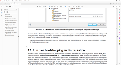

Sorry no, I just added the wrong name of the file, I meant the Kinetis Thread Stack Application Developer's Guide as you can see here.
Sorry for putting the wrong name of file, but in the Thread developers guide you can find the information I referred in the last post about the linker files when using the Fsci_bootloader.
Sorry for the inconveniences cause by the name error.
Estephania
11,565 Views
stephanie_m
Just to confirm, when you deploy your example with the HCD, did you make sure that you made the linker file changes mentioned in the BLE Application Developer's Guide? When using the fsci_bootloader you must change the linker file configuration of the project, if you did not make those changes there might be some memory issues , could you please check that and confirm ?
