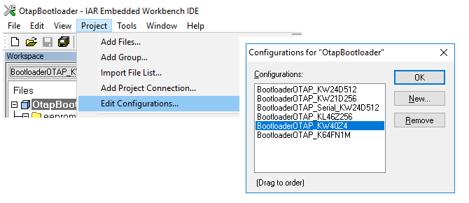

Project location framework\Bootloader

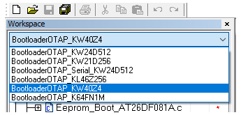

Target selection in project
or
Some parameters:
MCU_MKW40Z160
gEepromType_d=gEepromDevice_AT45DB021E_c
so gEepromType_d change should trigger a rebuild.

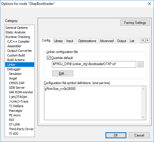

What about MCU change type from MCU_MKW40Z160 to MKW30Z  ?
Linker gRomSize_c=0x28000 param
other parameters might be:
gEepromParams_WriteAlignment_c, gEepromWriteEnable_d, gSerialBootloaderEnable_c,
gSPI_HW_TYPE_c, gSerialBootloaderEnable_c, BOOTLOADER_CRC_ENABLE, BOOTLOADER_ENABLE_VERIFY,
BOOTLOADER_ENABLE_READ_CMD, BOOTLOADER_INT_WATCHDOG
