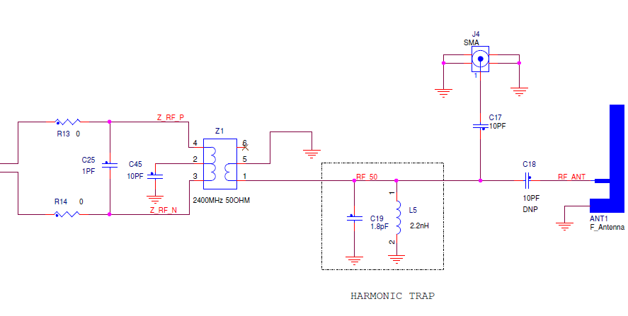

Using the Wireless UART example provided with BeeKit and Kinetis SDK, I am able to see packets being transmitted on Channel 15 by a TWR-KW21D256, captured by the USB-KW24D512 in packet sniffer mode(The TWR is also successfully receiving packets sent by another Zigbee dongle).  We have a prototype board with the KW21D512 which the Wireless UART mostly works EXCEPT for the radio transmit and receive, the packet sniffer is not seeing it transmit and the prototype is also not receiving from the other Zigbee Dongle.  UART and GPIO pins (LEDs and GPIO inputs) are all working correctly on this prototype board.  So what would be the best way to debug this issue?  The one thing I am concerned about is the EXTAL_32M and XTAL_32M was connected to a 24MHz external clock instead of a 32MHz, would this have any impact on the radio?
The radio hardware design is exactly the same as the TWR's.
From the documentation, the radio internally uses the SPI1 bus, we are using Port E Pins 0 to 4 as GPIO inputs, would this have any impact on this too?

I forgot to reply to this earlier, I had added a comment on my support request though on the clock.  It was actually a mistake on the schematic, it listed 24MHz but the Bill Of Materials actually called for a 32MHz and so the prototype board does have the same 32 MHz component as the TWR board.  The current suspect is C18 on the TWR board is a DNP 10PF capacitor where the prototype has a normal 10PF capacitor connected to the F Antenna.  Our prototype board does not have a external SMA antenna.

The capacitor in the TWR is not populated by default because it's using the SMA connector. In the TWR board, if you want to switch to use the Inverted-F antenna, you have to change the capacitor from C17 to C18.
Having said that, if your design already has the capacitor in place for the F antenna and you don't have the SMA Connector, your design should be working fine as long as all the RF circuitry is in place as the design files states.

Ah, I had looked through the TWR-KW2XHWRM.pdf and I didn't see any mention of needing to rotate the capacitor to enable the Inverted-F antenna (although I'm a software engineer, not hardware engineer).  So the DNP is Do Not Populate :smileyhappy:  Although interestingly if the external antenna is not connected to the SMA, it is still able to transmit and receive.

Thanks for the information so far.  I had the capacitor rotated from C17 to C18 so now it is using the Inverted-F antenna on the TWR-KW21D256.

We figured it out.  So in the end it was discovered the external 32MHz crystal/clock(connected to EXTAL_32M and XTAL_32M)MUST have capacitors, so by matching the 12pF the TWR has, our transmitting and receiving started functions in the correct frequency.  Without the capacitors, a Spectrum Analyzer showed it was transmitting at 2.4265 GHz which is too high.  We also discovered Chapter 32's OSC control register allows you to select internal capacitors to use but this does not solve the problem, external caps must be used.
