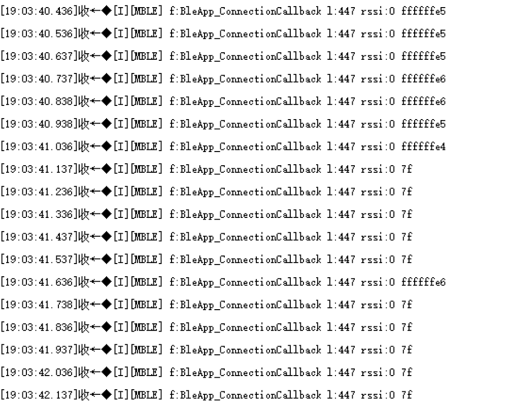

1、Using the api(Gap_ReadRssi) to get the rssi, we found that many results are 0x7f,the following is the log picture

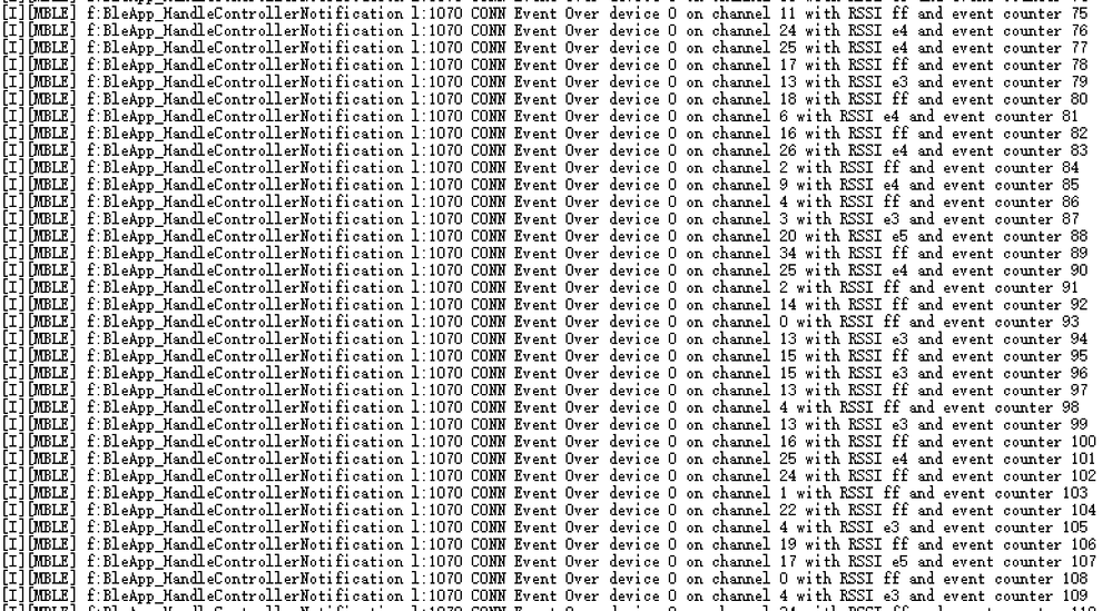

2、The rssi is obtained by the event(gNotifConnEventOver_c), and it turns out that there are many 0xff,the following is the log picture

Hi:
SDK version 2.12.6
SDK example:w_uart
#define Gap_ReadRssi(deviceId) Gap_ReadRadioPowerLevel(gRssi_c, (deviceId))
What I want to ask is to get rssi through the api(Gap_ReadRssi), but sometimes I get rssi 0x7f
you using our KW45B41Z Evaluation Kit?
