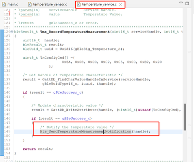

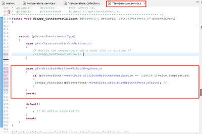

I want to modify the SDK examples:temperature sensor and collector so that collector can write Characteristic Value,The sensor can print out the values written by the collector through UART.
As shown in the picture, press the button of the sensor first, and the sensor sends the Notification. The collector triggers **GattNotificationCallback**, prints out the value "value_temperature", and then uses the API: GattClient_WriteCharacteristicValue Changes the value of value_temperature.The sensor triggers **GattServerCallback** to print the value of value_temperature.But collector can print value_temperature, sensor UART does not print, looking forward to your suggestions and guidance!

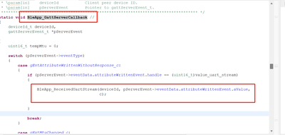

Ricardo_Zamora
Hope you are doing well. Is there any special consideration why the collector would need to write a characteristic to the sensor?
If you want to receive on a serial terminal something "received" from Bluetooth, maybe you can take the Wireless UART example as a base for your application.
This example already enables UART and bidirectional BLE communication.
Ricardo

I think "temperature sensor and collector" is more appropriate,Of course I also can take the Wireless UART example as a base for your application.But I have a question about the Wireless UART example,From my understanding of W_UART, BLE printing data to serial terminal requires the use of BleApp_ReceivedUartStream, which is only used in BleApp_GattServerCallback.Can Central also use BleApp_GattServerCallback?If not, how does Central transfer data to UART.

Ricardo_Zamora
With Wireless UART, even if the device is in central mode, the BleApp_ReceivedUartStream is called when receiving something from the peripheral.
Ricardo
