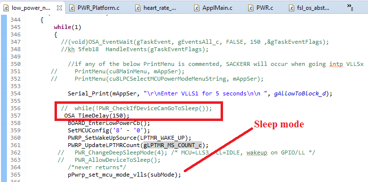

I must put either one of the function (OSA_TimeDelay() or PWR_CheckIfDeviceCanGoToSleep()) just can prevent the SACKERR.
Pls help me to investigate why i need a delay to enter the low power mode.

Thanks for the info. With the BLE heart rate demo, on our board, are able to get about 1uA when entering VLLS1. When we try on the FRDM-KW41, with J18 remove as shown in the photo, we cannot get the JTAG/debug to work, we need to insert J!8 to program and remove it to measure the current, is this correct?
We are working on sdk example wireless_example_smac_low_power_node, the power consumption is 16uA on our board.
We also tried to disable the port pins used in the code (mux=0) but the currrent still remains at 16uA Please advise where should we look at to get the same current consumption as the BLE heart rate demo.
Another question i have modified the code and why i cannot direct enter to low power mode need to put some delay just can enter to low power mode successfully else will get the SACKERR.
