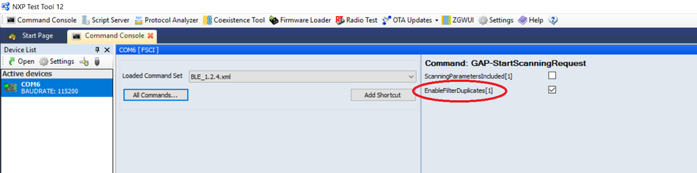

Xiang_Li
Hi Sensenthuran,
Can you be more specific on which "FSCI API is not exposing the duplicate filter". Provide more info in 1 go would save time for both of us.
If you are using FSCI, probably on the PC side you are using the Test Tool GUI?
Check this link for more info:
https://community.nxp.com/thread/465030
I did a quick check and in Test Tool you can see the parameter of control duplicate filter.

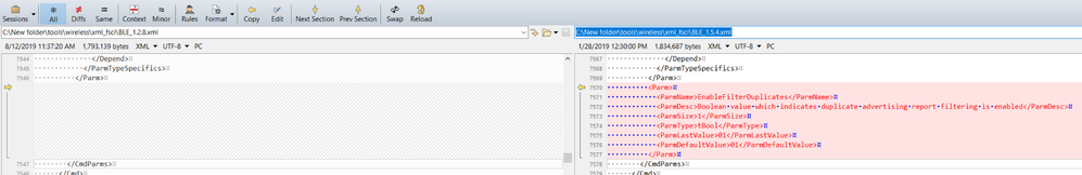

Xiang_Li
Thanks for pointing this out.
I think the root cause is that your BLE stack version is not to the latest. Currently I can see in the QN908x SDK the BLE version is 1.5.4.
But when I download the latest KW41Z SDK, its BLE version is still 1.2.8.
The ".h" file is generated from a xml file.
And if I do a diff between the xml files, I can see the duplicatefilter parameter has been added in the later version of BLE xml. See picture below.
But why the BLE software component are not kept the same between QN908x and KW41Z, that I have no idea.
Do you already have a workaround for this issue? E.g. you may hardcode the parameter in GAP to force the duplicatefilter to be true or false.
