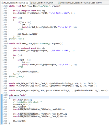

I am working on the KW38 platform and use the wireless-uart example as my code base. I tried to create two tasks in my project, but it seems that only one task can be successfully created and run. I made an example as shown below and then tested it. I found that the priority of the TASK will determine which TASK will always be executed and another TASK will always be broken. I also tried to redefine FSL_OSA_BM_TIMER_CONFIG as FSL_OSA_BM_TIMER_SYSTICK to enable OS Timer and use OSA_TimeDelay(1000) to delay the running task so that another task can work, but it still doesn't work. Did I do something wrong?

You need to increase the stack size. It is in the app_preinclude.h.

I can't find the stack size definition in app_preinclude.h (note: KW38 does not have FreeRots). I also referenced the app_preinclude.h of KW36 and found two definitions gMainThreadStackSize_c and gTotalHeapSize_c. But for KW38, only one stack size is defined as gMainThreadStackSize_c. I tried to extend this setting to 2048, but it still fails. Is there a more detailed explanation, Thank you.

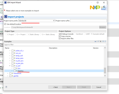

You are using bm example. So it is impossible to create the task. Please use the freertos example.

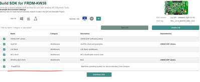

As I mentioned before, the example code of KW38 does not provide FreeRTOS project, Could you please confirm again, Thanks.
