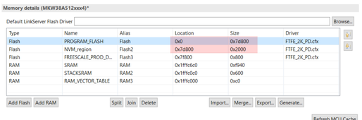

I am trying to use OTAP Client Software to reprogram kw38, and I referred to this document :KW38 - Reprogramming a KW38 device using the OTAP Client Software
After I done all the process ,the app shows that transfer successfully.

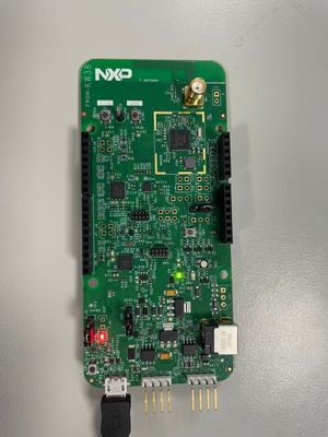

But kw38 EVB didn't work as expected, instead, it was acting like this:
What should I do?
Thank you for your help!

Hi @Lincoln,
Please look at your memory regions, you did not change location of flash and the NVM_region.
Please change the regions as the image below.
Mario

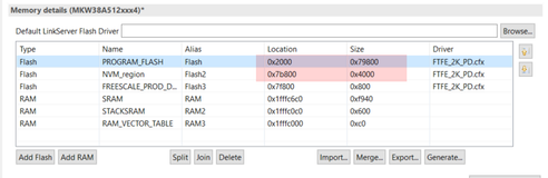

mario_castaneda
Hi @Lincoln,
Mario

Lincoln
Hi @mario_castaneda,
it works after I change the memory region, thank you very much!
