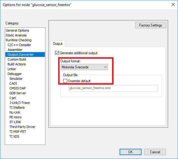

3- Go to "Output Converter" window. Deselect the "Override default" checkbox, then expand the "Output format" combo box and select "Motorola S-records" format. Click the "OK" button to finish.

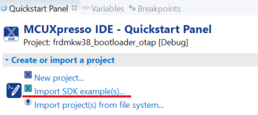

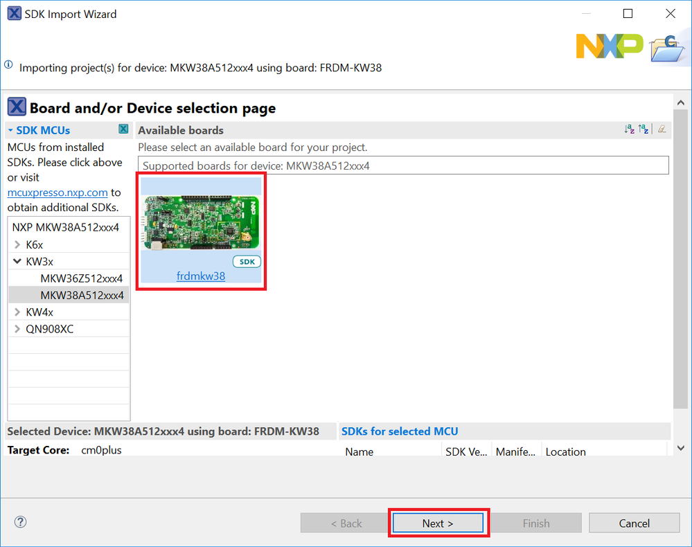

1- Open MCUXpresso IDE. Click on "Import SDK example(s)" in the "Quickstart Panel".
2- Select the FRDM-KW38 icon and click "Next >".
3- Import the OTAP bootloader project. It is located in "wireless_examples -> framework -> bootloader_otap -> bm -> bootloader_otap". Click on the "Finish" button.

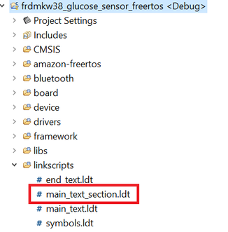

3- Unzip your KW38 SDK package. Drag and drop the "main_text_section.ldt" linker script from the following path to the "linkscripts" folder on your workspace. The result must be similar as shown in the following figure.
<KW38_SDK>\middleware\wireless\framework\Common\devices\MKW38A4\mcux\linkscript_bootloader\main_text_section.ldt

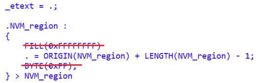

4- Open the "end_text.ldt" linker script file located in the linkscripts folder in MCUXpresso IDE. Locate the section shown in the following figure and remove "FILL" and "BYTE" statements. BYTE and FILL lines are used to fill with a 0xFF pattern the unused NVM flash memory region. Removing this code, our software image will not contain this pattern, in consequence, the image reduces its total size and it improves the speed of the OTAP download and memory usage.

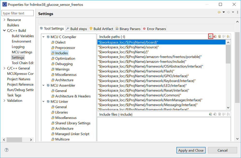

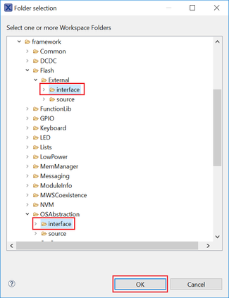

7- Go to "Project -> Properties -> C/C++ Build -> Settings -> Tool Settings -> MCU C Compiler -> Includes". Click on the icon next to "Include paths" (See the picture below). A new window will be displayed, then click on the "Workspace" button.
8- Deploy the directory of the project in the "Folder selection" window, and select "framework -> Flash -> External -> interface" and "framework -> OtaSupport -> interface" folders. Click the "OK" button to save the changes.Untitled.pngUntitled.png
9- Ensure that "OtaSupport" and "External" folders were imported in the "Include paths" window. Then save the changes by clicking on the "Apply and Close" button.

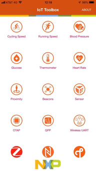

1- Open the IoT Toolbox App on your smartphone. Select OTAP and click "SCAN" to start scanning for a suitable OTAP Client device.
